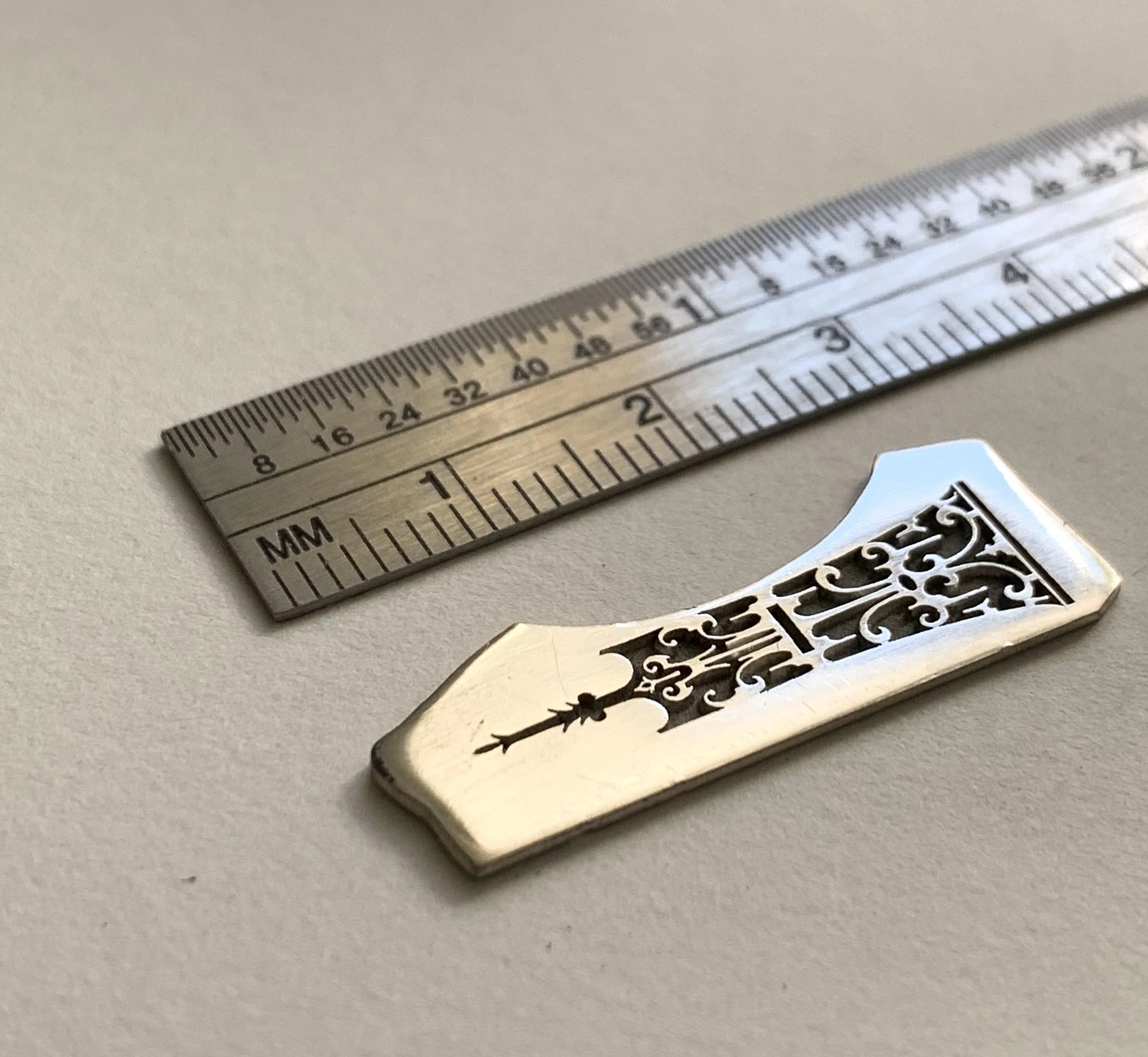

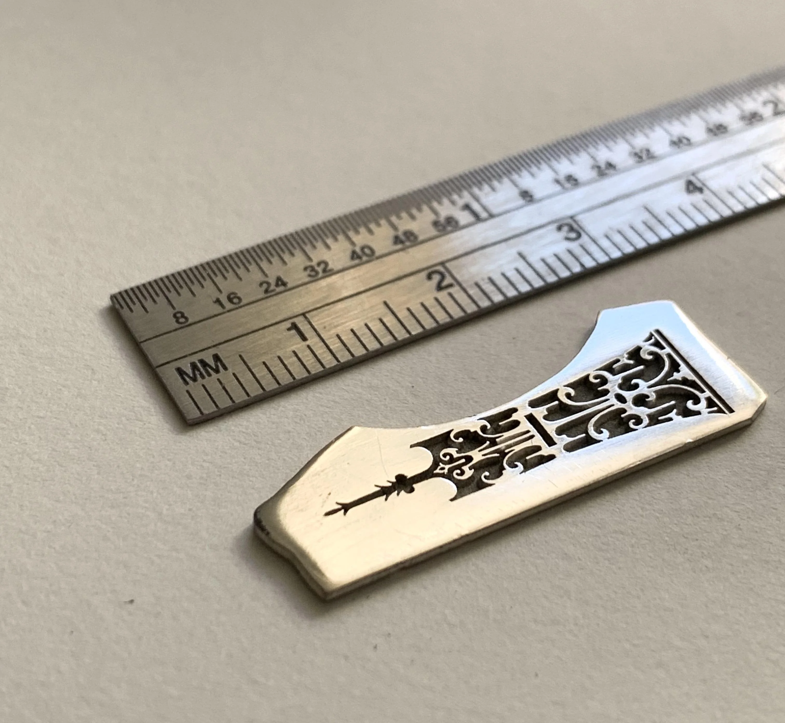

xTool F1 Ultra Laser Engraving Embossing Silver Plates
I’ve used my F1 Ultra to engrave 0.5 mm deep (and probably deeper) in sterling and fine silver. Rather than the Engrave process which limits the number of passes to ten I will use a .png with my design in black on a transparent background and go with Emboss—my go-to settings for silver and brass are Fiber IR, 120 layers, 95% power, 300mm/sec speed, 1 pass, 300 lines/cm, 7° engraving angle, 30kHz, z-axis descent 0.01mm each layer. - PopeCovidXIX: A question on engraving.
