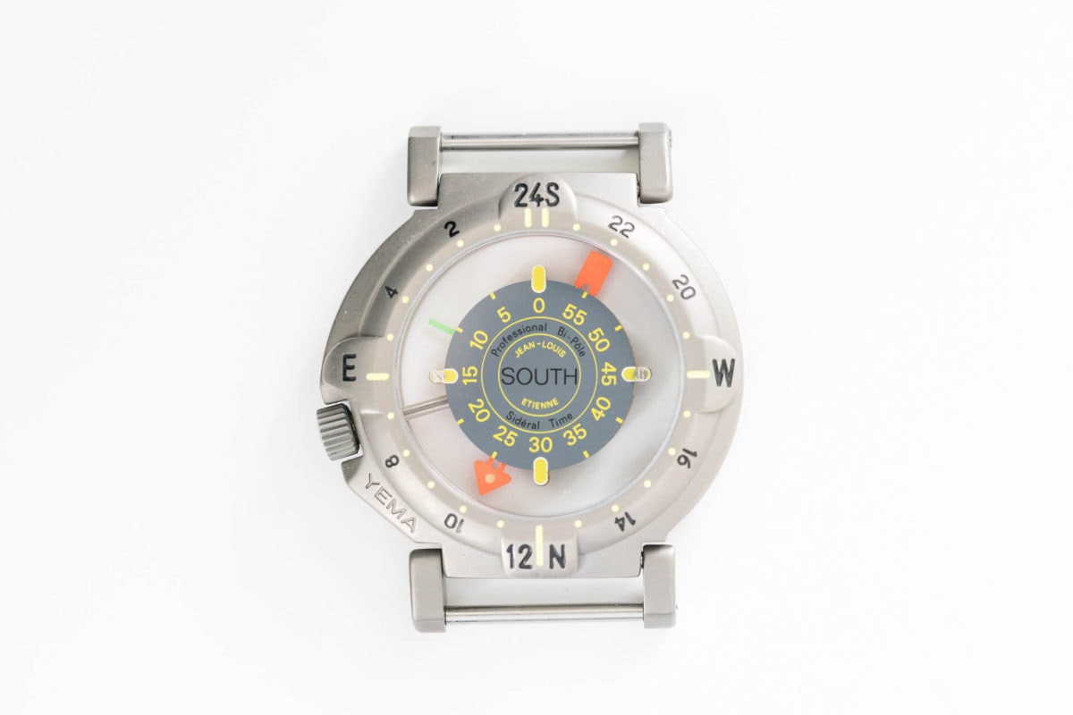

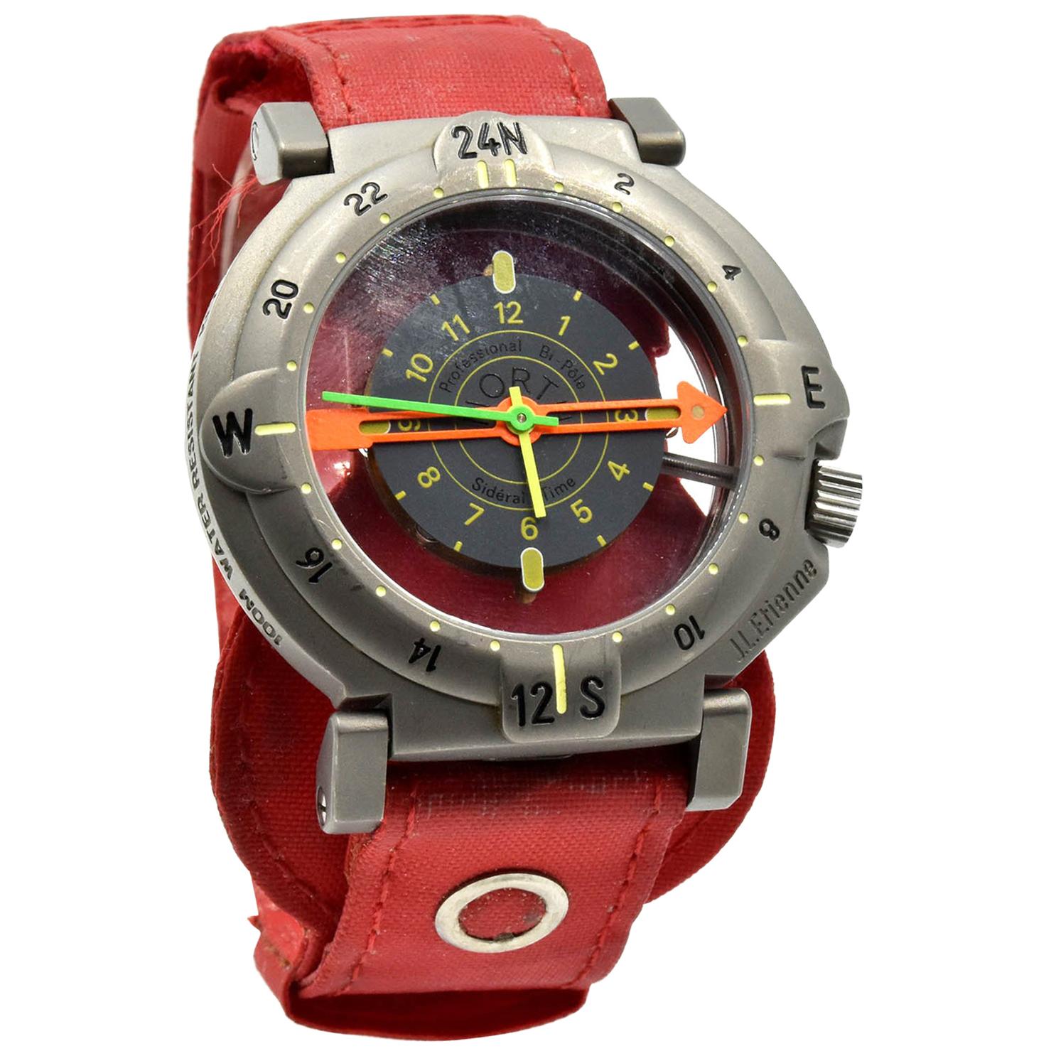

Attached to this post are images of the watch style that I worked on, but this is not the exact watch, as I just downloaded some pix off the net and am using those.
