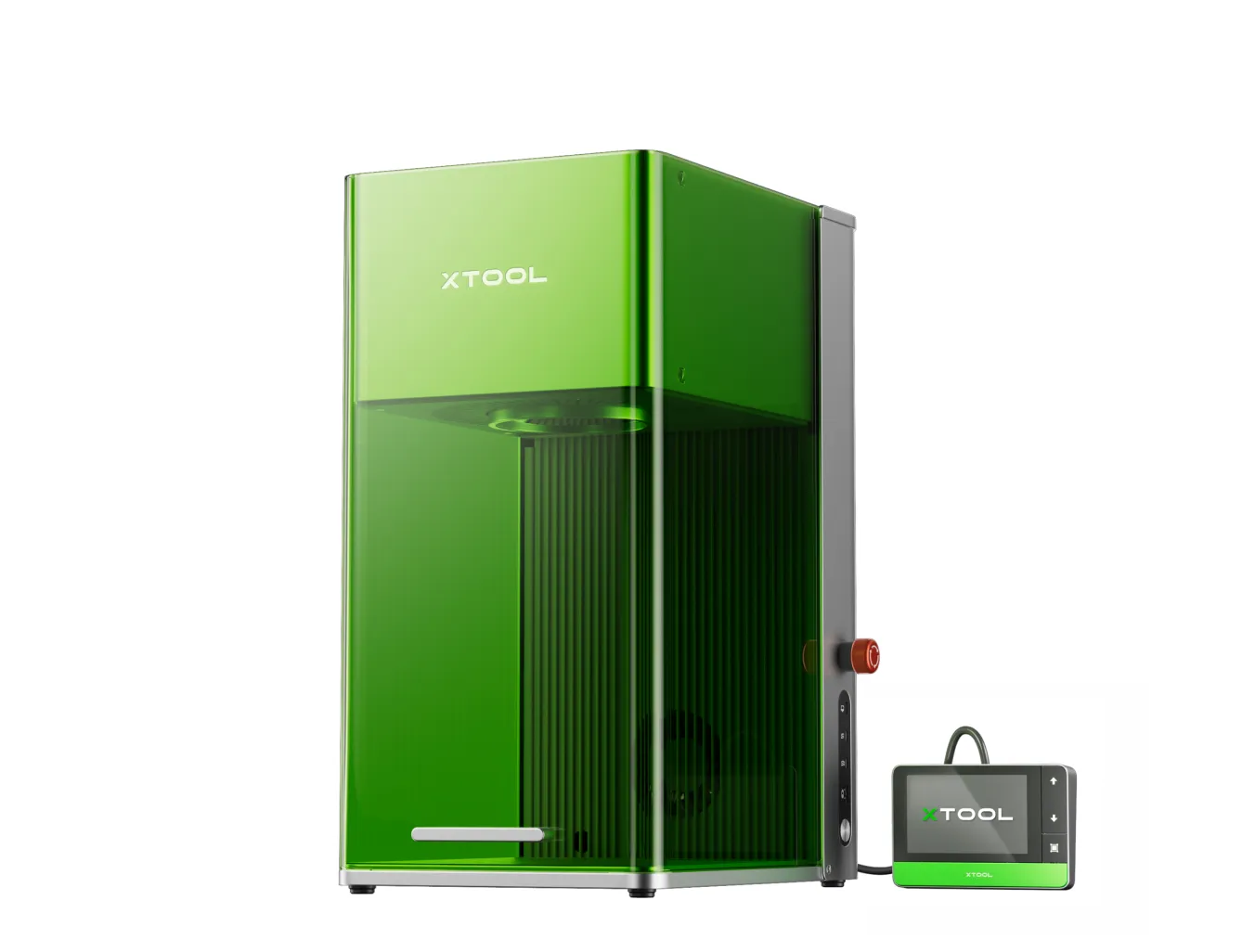

I am going to be posted various items about the xTool F1 Ultra laser engraving machine, most of which will be part of my trial and error as I learn how to use the system. My intent is to post general tests in this thread, then if I find good settings I may create a separate thread with just those settings for reference.
xTool F1 Ultra Laser Engraving Machine Testing
