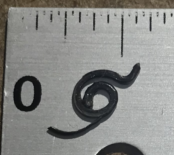

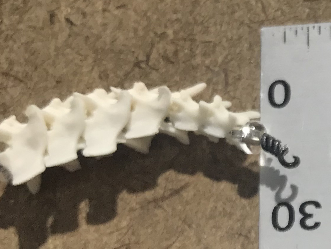

I am creating earrings with bone and wire. I can get nickel silver and bronze from Rio Grande, and a gold tone brass from Amazon.
What I really need is a black or gunmetal wire with the same tensile strength as all of the above in 18, 20 & 22 Gauge diameters.
Thus far the only dark wire I can fine is a coated copper or aluminum. When these are worked the wire either loses its coating or breaks from being manipulated. I have bought Benecreat, Artistic Wire, Mandala Craft Wire, Fire Muntain's Black wire and one or two from Amazon.
They all are problematic.
I am creating in one case a spiral that is then flatten, and the bones go on and the wire is wrapped to hold a finding.
I have talked to Garlan Chain, as they offer dark chain, which is obviously made from wire, but they send their wire out to be coated.
I have wondered about titanium, yet can find no black or gunmetal in that medium.
Does anybody have ideas for me to either search for a term I am not using, or are you buying dark wire and don't mind sharing your source?
The images give you an idea of what I am up against,
