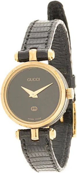

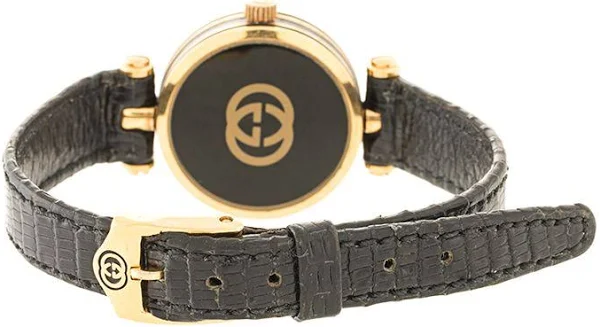

There is a ladies round dial Gucci yellow metal watch with black trim, a single lug on top and a single lug on bottom (two lugs total), that sometimes comes in for battery replacements. This watch has a crystal on the front and on the back.
FRONT:
BACK:
