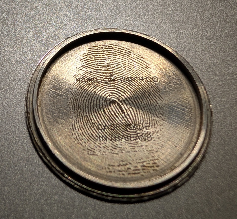

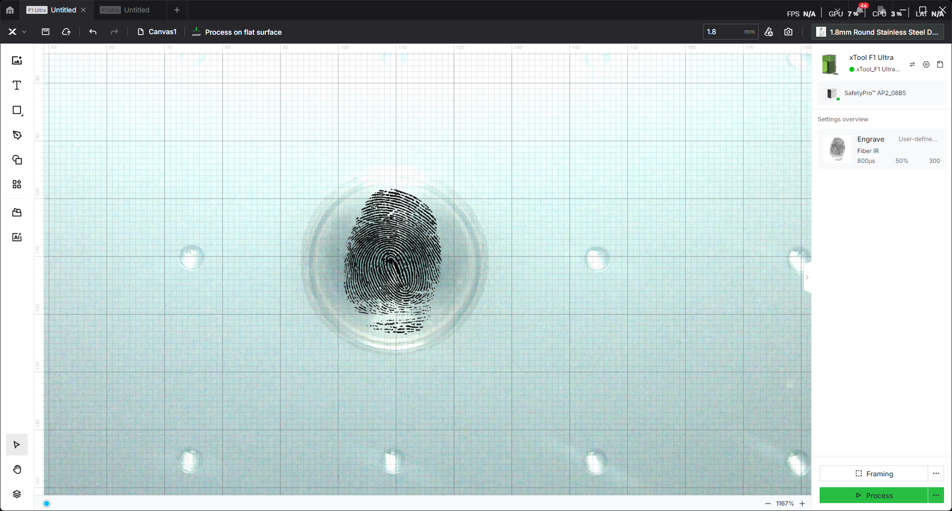

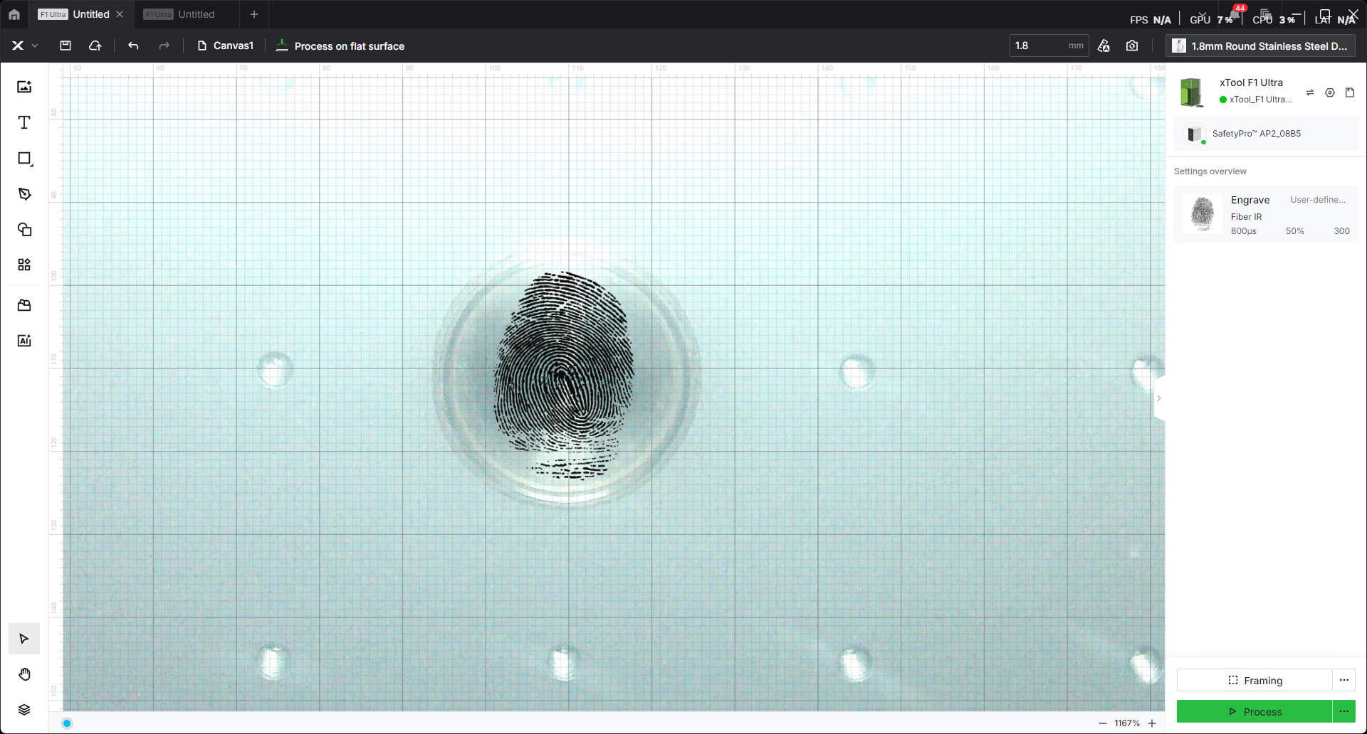

Engraving a fingerprint, taken from Wikipedia (below), on the inside of a stainless steel watch back (had it handy from some testing), I tried Fiber IR, duration of 800µs (microseconds), power at 50%, dpi of 300, 2 passes, Atkinson bitmap mode, bi-directional engraving mode, and a frequency of 30 kHz. As it is an image, the only option XCS gives me is to engrave it, as opposed to etching or cutting. I like to use the Framing option to make sure the work area is correct. Close the case. Process, let it calculate an estimated time, Start (top right), press the xTool button on the screen. After the job ends (40 seconds), OK button.

XCS screenshot (nothing fancy, just slapped the image on there for this post):
Engraved inside of watch back ("raw"):

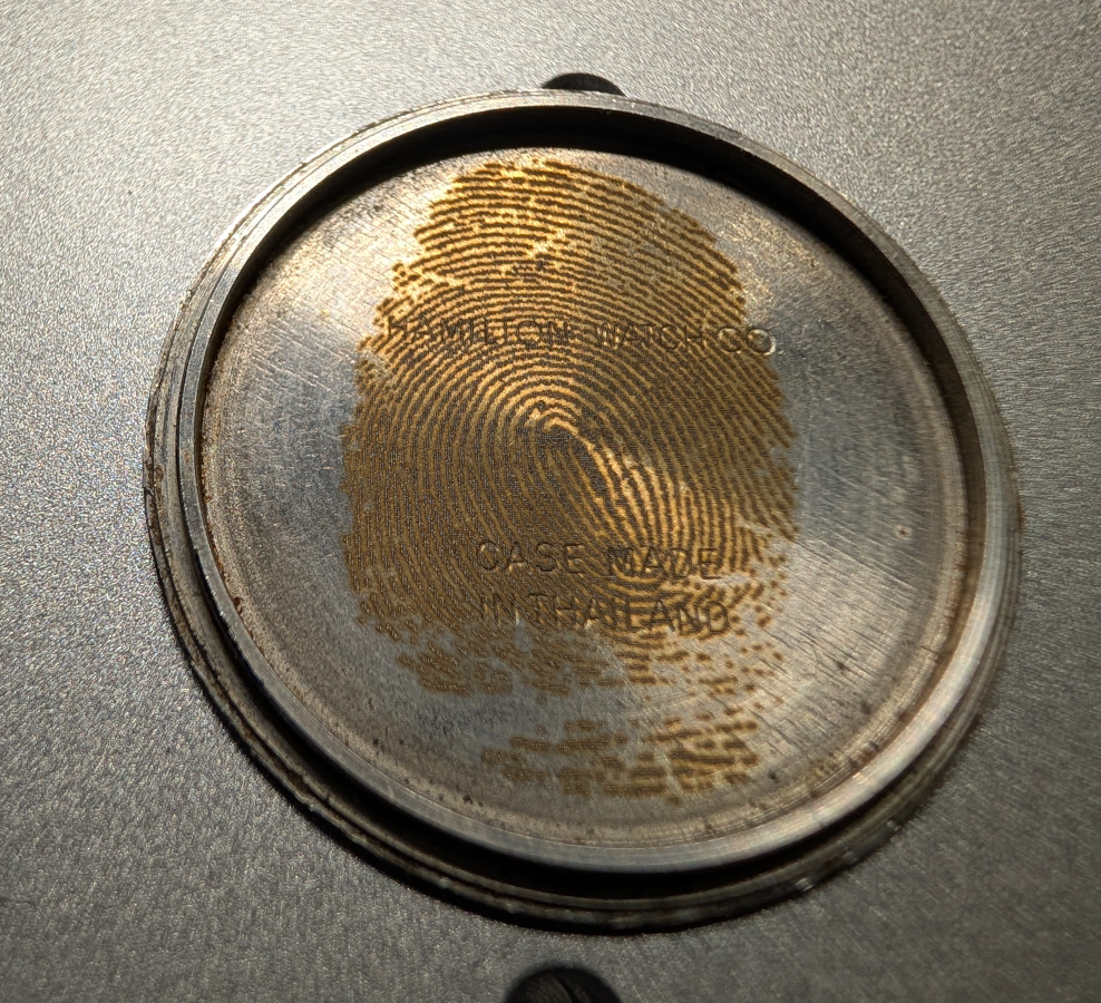

Engraving inside of watch back (after super quick paper towel wipe):
I am curious if a third pass would be worthwhile or not. Also, if a spray would help define the engraving color better would be an interesting experiment.
